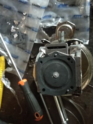

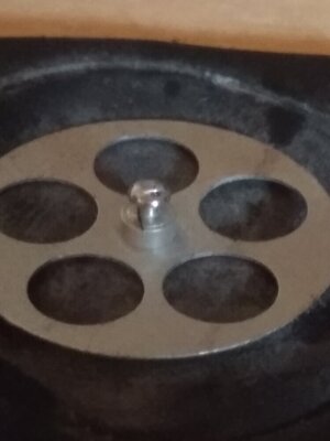

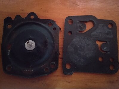

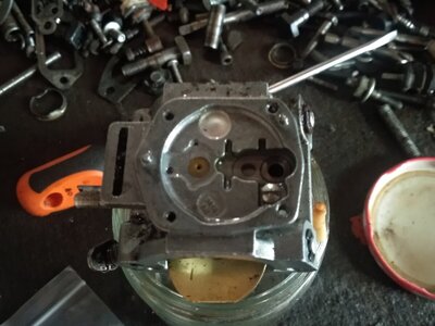

hello again guys,
Well, I will tell you, today I have disassembled the original carburetor of the machine and I have cleaned it, inside it is apparently very healthy, the membranes it had were very old and hard so I put a new carburetor repair kit on it, before that I have cleaned the carburetor from the inside with a product and I think it has turned out very well, the bad thing is that when I have assembled everything, the carburetor needle stays open and it continues to put gasoline into the machine, I have assembled the reconstruction kit well with the joint below the membrane, but even so the needle remains a little open and gasoline continues to enter the machine and logically it drowns, so I have to disassemble the carburetor again to see what happens there, but it seems that everything is going well that in not a long time the machine will work again.
I put some photos

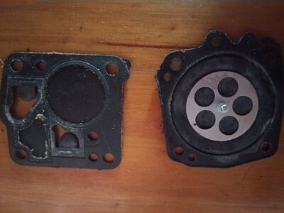

The old membranes

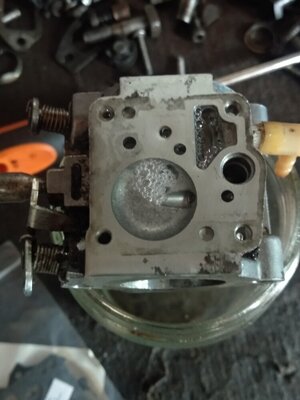

The carburator

when reassembling the metering side, are you being sure that the lever gets hooked onto the nub on the diaphram? if not then you will keep the valve open and flood.

Hello, good morning from Spain, what do you mean by "the lever gets hooked on the protuberance of the diaphragm"? The needle lever is mounted and the protuberance of the diaphragm of the membrane acts on it, but it does not engage in the lever.

Is the level hooked on that part of the membrane?
You can also pressurize the fuel hose into the carburetor when its off of the saw, it should hold 15psi .

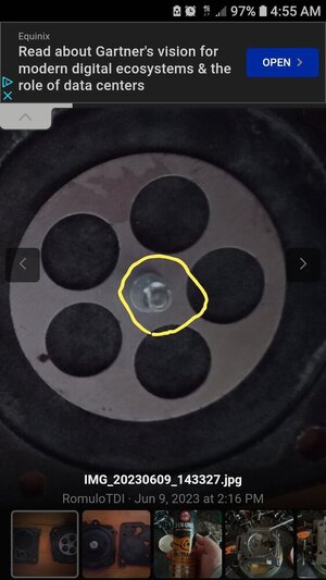

Hello again, I just looked at the old screen and I understand that you mean that the lever must fit here, in this groove of the protrusion, right? The truth is that I have not noticed if the new membrane has that bulge, I understand that if it should have it, when I have free time I will disassemble it and look.
Thank you.
All the best.
Correct.
